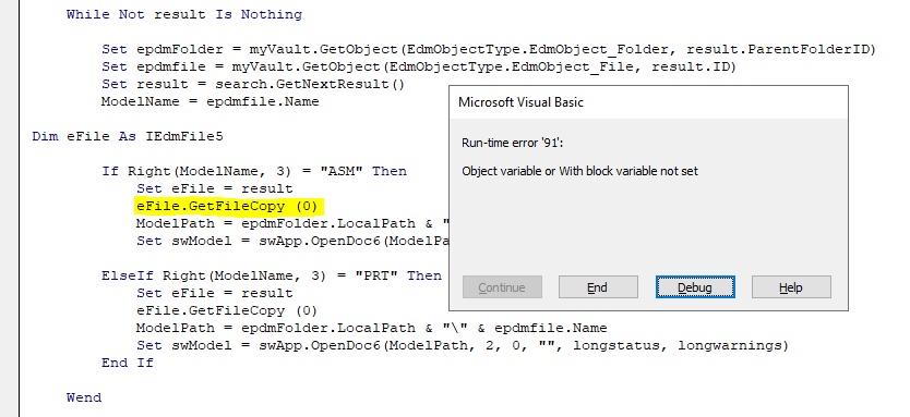

Hello friends,
                Through forum help, I had created a macro that will find the part or assembly from PDM Vault and Gets the Latest Version of the file and be opened in the SolidWorks.
It works well for some files but not for all… Please see below for my code…

Sub main()
Set myVault = New EdmVault5
myVault.LoginAuto "PDM-VAULT", 0
Set search = myVault.CreateUtility(EdmUtility.EdmUtil_Search)
search.Clear
DesiredFile = "G2640"        ‘------------file name
search.FindFolders = False
search.FindFiles = True
search.FileName = DesiredFile & ".%"
search.Recursive = True
search.SetToken Edmstok_Recursive, True
Set result = search.GetFirstResult
Set epdmfile = Nothing
Set epdmFolder = Nothing
    While Not result Is Nothing
        Set epdmFolder = myVault.GetObject(EdmObjectType.EdmObject_Folder, result.ParentFolderID)
        Set epdmfile = myVault.GetObject(EdmObjectType.EdmObject_File, result.ID)
        Set result = search.GetNextResult()
        ModelName = epdmfile.Name
Dim eFile As IEdmFile5
        If Right(ModelName, 3) = "ASM" Then
            Set eFile = result
            eFile.GetFileCopy (0)
            ModelPath = epdmFolder.LocalPath & "\\" & epdmfile.Name
            Set swModel = swApp.OpenDoc6(ModelPath, 2, 0, "", longstatus, longwarnings)
        ElseIf Right(ModelName, 3) = "PRT" Then
            Set eFile = result
        End If
    Wend
      Debug.Print ModelPath
End Sub
Could someone help me where I am missing…
