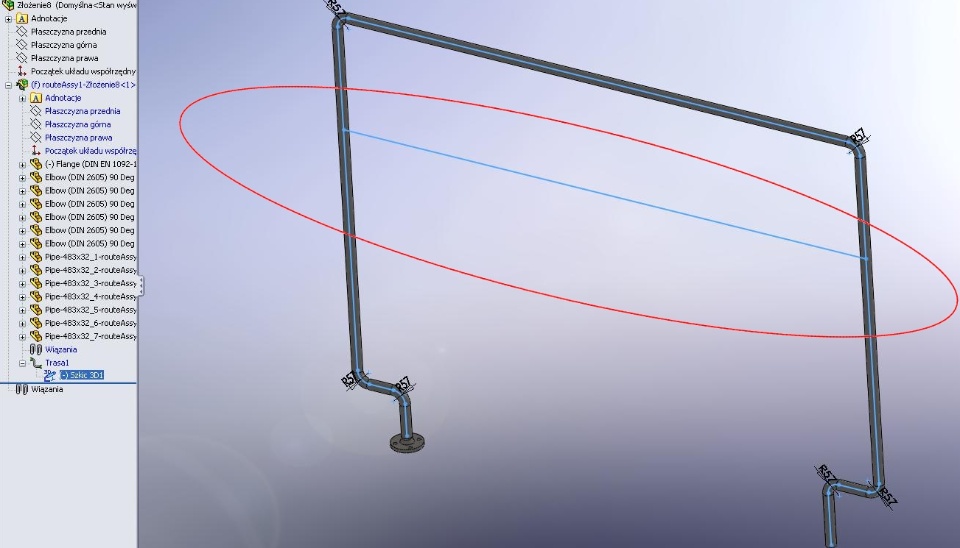

Note: I can't use any elbows - there should be apenetration.SolidworksRouting

Hi Pawel,
You have hit on a scenario that penetrates cannot handle.
The basic problem is that every route segment must have a referenceto at least 1 CPoint because it is the CPoint that determines thepipe diameter. In this case there is no CPoint.
my best suggestion would be to use an O-let at one end. You canmodify the O-let definition such that the CPoint is inside the thepenetrated pipe so that you get a proper length. You can then hidethe O-let component and set it to ignore in BOM.
Using this at both ends will work well. This will not cut a hole inthe penetrated pipe or shape the end of the penetrating pipe but itwill get the pipe modelled.
You can use the custom pipe function to allow you to cut the endshape on the pipe if it is essential to have this detail.

Someone out there may have a better idea?
Hope this helps.
