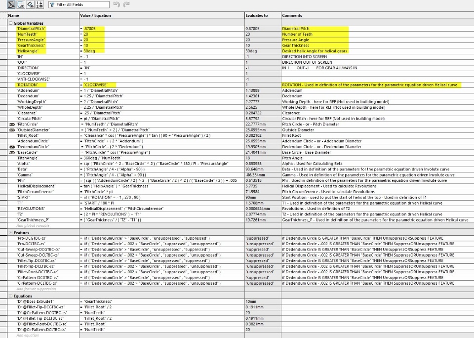

Or, as attached and have set Global Variables for:
CW Rotation, 20 Teeth, 30 Deg Helix Angle, 20 Deg Pressure Angle
“Involute Helical Gear Generator - CW 20T 30 Deg 20 PA.SLDPRT”
Involute Helical Gear Generator - CW 20T 30 Deg 20 PA --- Equations
"DiametralPitch"=.87805
"NumTeeth"=20
"PressureAngle"=20
"GearThickness"=10mm
"HelixAngle"=30deg <- The Desired helix Angle for this helical gear
"ROTATION"="CLOCKWISE"
After changing the above values to the desired values in the Equations and
Performing at least two Control “Q”s on the model.
The model should rebuild and show the new tooth count etc…

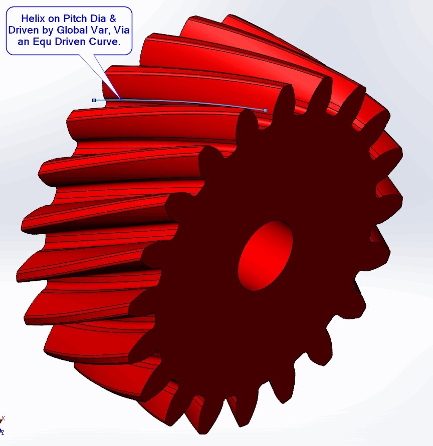

I have set the path the tooth cut follows as a helical “equation driven curve” set to be
on the pitch diameter and at the helix angle set as a global variable.

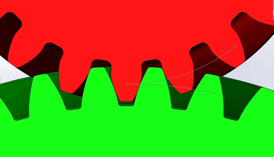

The below showing the mesh of my 20 tooth and 50 tooth Helical gear.
20T CW to 50T CCW Helical Gear Mesh Assy
