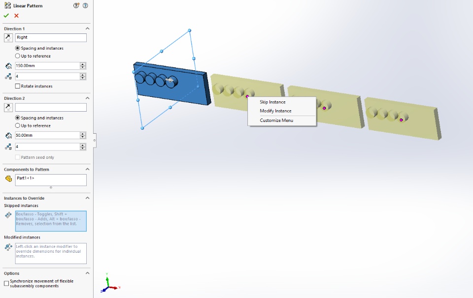

Anyone know why my instance selection orb keeps bringing up menu instead of toggling the instance now? Can't find how to switch it back. Please help fix the madness. :)
The 'Modify Instance' was added in SW2020 and it does seem to create a breaking UI change (functionality that was there isn't anymore). However, you can window selection the instances to skip, which is probably a little faster than dealing with the popup menu.
