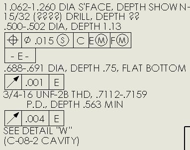

Does anybody know how to do this? Its easy enough to create anote, and even insert the symbols in the note, but I need thecontrol framing around the symbols and text.
All this can be done very easily thru the interface, but I haventbeen able to figure out how to do it with the API. Using the macrorecorder to record the process thru the UI generates bogus code:
