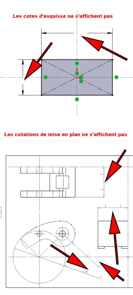

After having completely uninstalled Solidworks with Total Uninstall then reinstalled Solidworks 2021 SP0.
I can no longer dimension my sketches or my drawings,
Ditto for the existing files before uninstallation, the sketch and drawing dimensions no longer appear.
Also when I extrude a sketch with the boss feature, solidworks crashes.
Message
Solidworks module out of order; sldrsu: 00185258
Could you help me ???
Is there a complete SolidWorks uninstallation tool to try a new installation ???
Thank you for your answers
Herewith screen copies of the sketch and drawing with missing dimensions

GS 2021-09-14
I don't expect it to help with the crashing, but see if anything at https://www.cadforum.net/viewtopic.php?f=17&t=98&p=883#p883 will help with the missing dimension text (the first thing mentioned there fixes a lot of graphics issues).

PF 2021-09-15
Don't even proceed with this buggy version and go straight to 2021 SP4.1, otherwise it will cause you weeks of rework later, trying to fix what SP0 breaks​.

FL 2021-09-15
First, turn off "Enhanced Graphic Performance" and see if it help.
