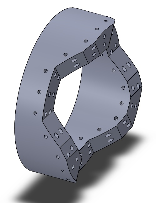

I've imported an STP file and ran the diagnostics/FeatureWorks on it in order to get all of the geometry to load. However, there is a portion that I cannot view. I don't know how some of the cuts/features were created, but I need to understand it in order to recreate this model into different sized diameters. Can anyone figure out how the original creator of this file added the cuts/angles of the geometry?

I do it in other solution. Look bottom.

But on this (your) solution is difficult have a control for cut angle (red). Need make few reference geometry.

Hi  ..  I agree, solids would be better (cut/mirror/patter),.. I was only providing clues by showing the surfaces visually extended.

Paul, build this surface on step model is simply but after we have much problems with configurations dimensioning. Better make this as solid.

Its simply model. I don't use surfaces if I don't must. Much times make trouble.
Maybe like this:
Here your STEP with new geometry.

Please forget Feature Recognition.  It only works for shapes simple enough that you don't need it.  All it can do is look at the dumb geometry and try to "guess" what features can make it.  It cannot reverse-engineer design intent.  To change the size of this thing, you have to know what it does and what it's for.  You have to know why the angled parts are the way they are in order to properly modify it.
That said, the actual cuts are just normal to the Right plane and then increments of 60/120/whatever.  Start a sketch on the Right plane and use Convert Entities, and you can add dimensions to measure the angled cuts.
