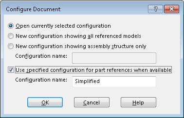

I have a assembly with 2 parts:
- assembly : has only "Default" configuration
- part 1: has only "Default" configuration
- part 2: has "Default" and "Simplified" configuration
When I open the assembly with the following "Advanced" settings:
It opens with part 2 in "Simplified" configuration and the rest in "Default" configuration.
Now I save the assembly and close it.
When I open the assembly again normally, then part 2 will be displayed as "Simplified" configuration.
I would like to be able to open the assembly normally with only "Default" configurations for all parts.
Without having to select "Advanced" and use "Default" in the dialog:
So I need the vb code to open an assembly with only "Default" configurations for all parts/sub-assy's in it.
Is there somebody that can help me with this ?
