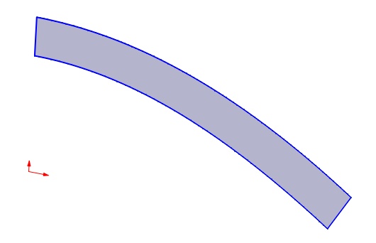

I have a surface in 3D sketch:

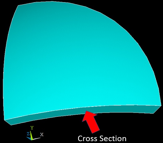

Now I want to make a volume like this from the above cross section:
I am not sure how I can do it. Any idea how to make it?
The SolidWorks file of the cross section is attached.

Thicken is grayed out in this case. Moreover, I do not think this feature could produce the figure I provided. Could you explain how it may work?!

You can try converting the 3D sketch into 2D (sketch on the front plane and convert entity) and do a revolve

..you said it was a surface... but after opening your file, it is a sketch.. so, you need to make a surface using Fill.. then you can Thicken.. (image)

Hello Jafar,
I have tired to
- Convert Entities to form a new Sketch
- Then using this new sketch, Revolved the Geometry.
I have attached the file for your reference.

Thanks. This is what I was trying to figure out.
