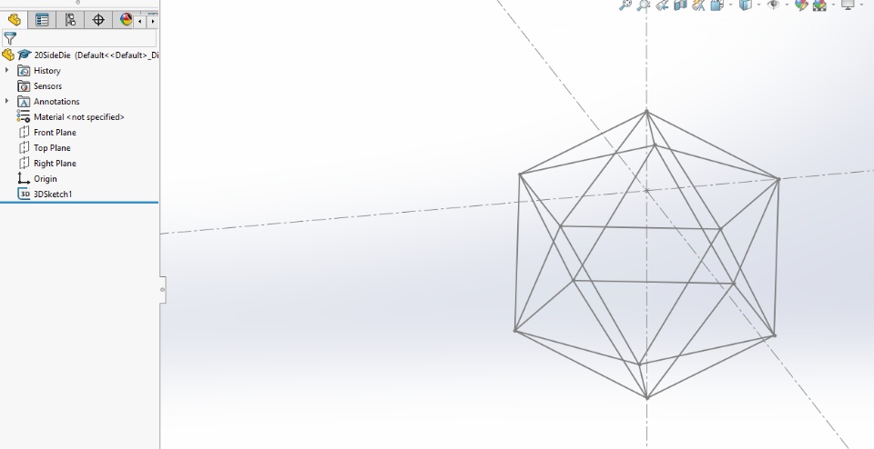

So i have made this 20 sided die in a single 3d sketch and i am really unsure how to make it a solid? I use a single sketch so it is much easier to control the dimensions of the die.

You could create Surfaces for the individual faces using the lines of the sketch, then Knit the Surfaces together and use the "Form Solid" option.

1) Create a hex mid-plane extrude for the middle portion and add a vertex chamfer.
2) Circ pattern the chamfer.
3) Centerline loft the top face, then the bottom face.
