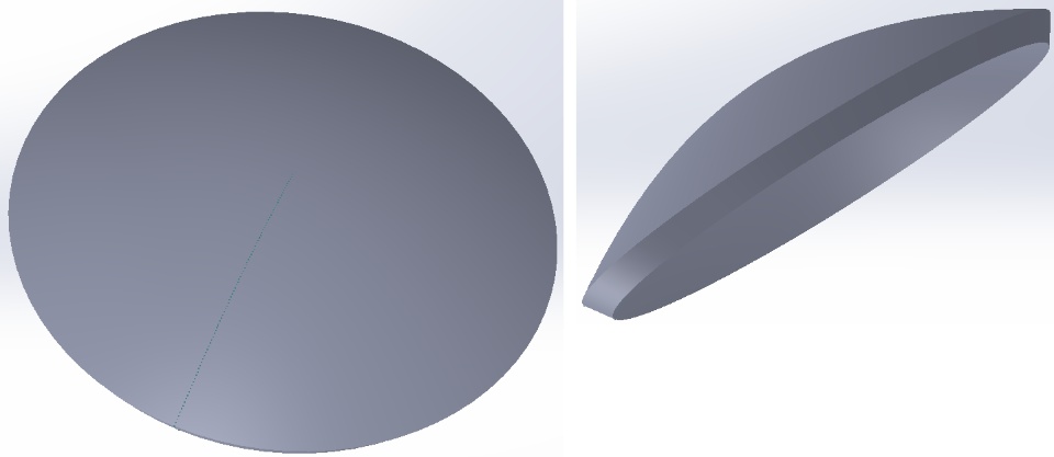

I have made 10 Boundary Surfaces using some splines. Here is what I have made:
Now I am trying to revolve (Mirror, etc) all of the 10 surfaces to make a 360 model. To be more specific I am looking for something like this:
Does anybody know how I could do it? (SW file is attached)
Thanks in advance for your help.

Why You don't use feature "Revolved/Boss" ? and make this as solid?
Can You attach STEP file? I have old version SW.
How this do it?
1. Select this blue face
2. Click "Revolved Boss"
3. Click "Convert Entities" ikon from sketch palette and accept sketch.
4. In Property Manager select as axis red edge. Use 360 deg. angle and OK
5. Coffee and smile.

I do not know why you need in a particular way. If end shape is the intention it is easy to do by surface, revolve and thicken.
JM
JM 2020-01-18
Thanks. I have tried what you are suggesting before but by revolving the blue surface with respect to red edge some parts of the top and bottom surfaces will be missed.
That is why I am looking for a way to duplicate all of these 10 surfaces so I could obtain a full circular 3D model.

You can generate "Intersection Curve" your surfaces with plane and revolve it.
1. Make point on arc. edge
2. Select this point and red edge and make plane (like this blue)
3., Select this plane and your surfaces and use "Intersection Curve" command. Result - yellow shape
4. Use this new sketch for revolve boss feature.
5. And of course coffee and smile.

Thanks Maha. Yes the final design looks nice and this is what I am looking at. However in the file you attached, you have used a lot of features and it is kind of hard to follow. At the end, I am looking for a 360 degree of the model I attached.  This model is for 90 degree. I was wondering if it is possible to somehow copy (Mirror, etc) this part so I can have a 360 degree model. Once thanks again for your assistance.

This is (I think) the simplest method because the curvature of the dome is not an arc. It's a splain. If the curvature were an arc, a different angle would come out (or maybe the thickness is not constant . See picture. Now you have all what you need, Like as write before: revolve this shape. As center line select this red edge from my previous message.

Thanks it looks promising. Could you please explain how it guarantees that this revolve captures the top and bottom surfaces (my original file for 90 degrees)? For example as I explained, if I create the cross section and do a simple revolve like:
In this case the top and bottom surfaces are not exactly the same thing that I have in my original file. Now I want to know how the revolve you have made is different from the simple revolve you can see in the above figure.
