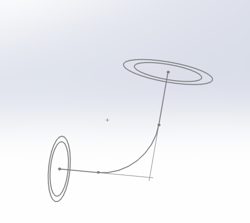

How to loft 2 profiles between this guide curve?
Hi guys, I am having trouble doing a swept boss or loft feature between two different circular profiles , they must follow the guide curve ive drawn. can somebody please guide on how to achieve this? It will basically become a 90deg Elbow with 2 different end diameters
Comments 3
MN
MN 2021-09-03
Delete inside circle, use centerline parameters to loft and shell it.
JH
JH 2021-09-07
Make sure the radius on the drive curve(elbow) is large enough to allow your larger diameter to swing around it without overlapping on itself.
FM
FM 2021-09-07
Ahh yes, the hidden power of the selection manager. That has to be the best way of doing it @Joseph
