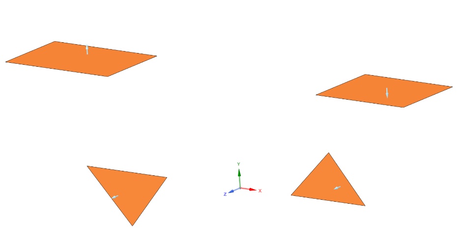

4. You can open the file in some 3rd party program. For example, here is a screen capture from Ansys Spaceclaim where I used the Measure > Normal tool to show the normal direction of a simple imported model. I believe many other tools can extract this info as well.
