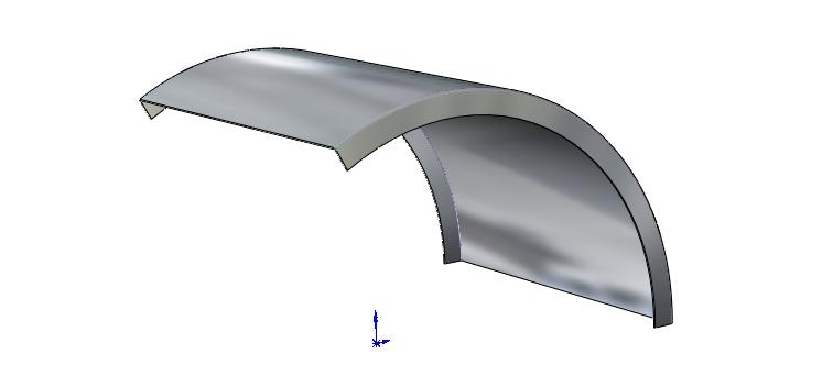

How to create this part in sheetmetal?
I am having trouble creating this part in sheet metal, doesanyone know if there is a way to do it?
ThanksSolidworksSheet Metal
Thanks
Tom -
See the attached.
Create 17mm arc flange first, then create the curved "body" second.Finally, mirror that to get the other side of the fender.
SF
SF 2007-04-27
Is the part to be rolled or formed?
