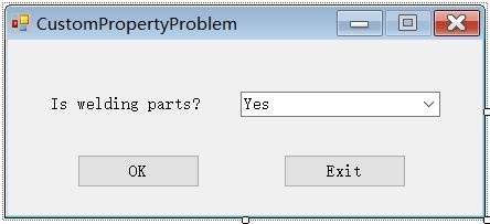

Windows form as below:

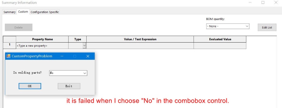

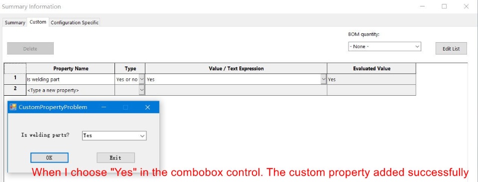

The problem is:
When I choose "Yes" in the combobox control. The custom property added successfully. But it is failed when I choose "No" in the combobox control. I don't know where the problem?
Is there anybody can help me?
