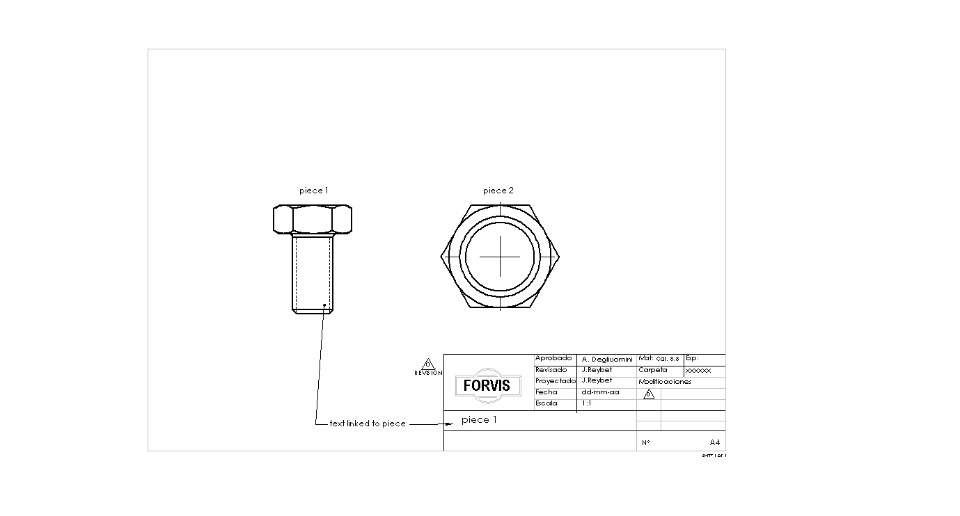

How to change the main piece in a drawing?
Hello, I hope you can help me, As you can see in the example I have two pieces inserted in a drawing. How can I change the piece, which is linked to the related texts in the drawing, for the other piece?
I hope you understand me,
Thank you.
 My drawing is already linked to a piece, what I intend is to change all the links to another piece that is inside the drawing

the quick way is through the sheet properties - change the view that is "driving" the property values.

Yes, I have already done that and it works, but I don't want to remove any pieces since they both belong to the same drawing. I thought maybe a possibility of making the change without deleting the pieces

Oh, in that case, right click on the desired sheet and select which view you would like to use to populate the properties

Delete the piece you don't want and see if link works.
If not, delete both pieces.
Insert the piece you want.

The version I use is 2018, My drawing is already linked to a piece, what I intend is to change all the links to another piece that is inside the drawing.
