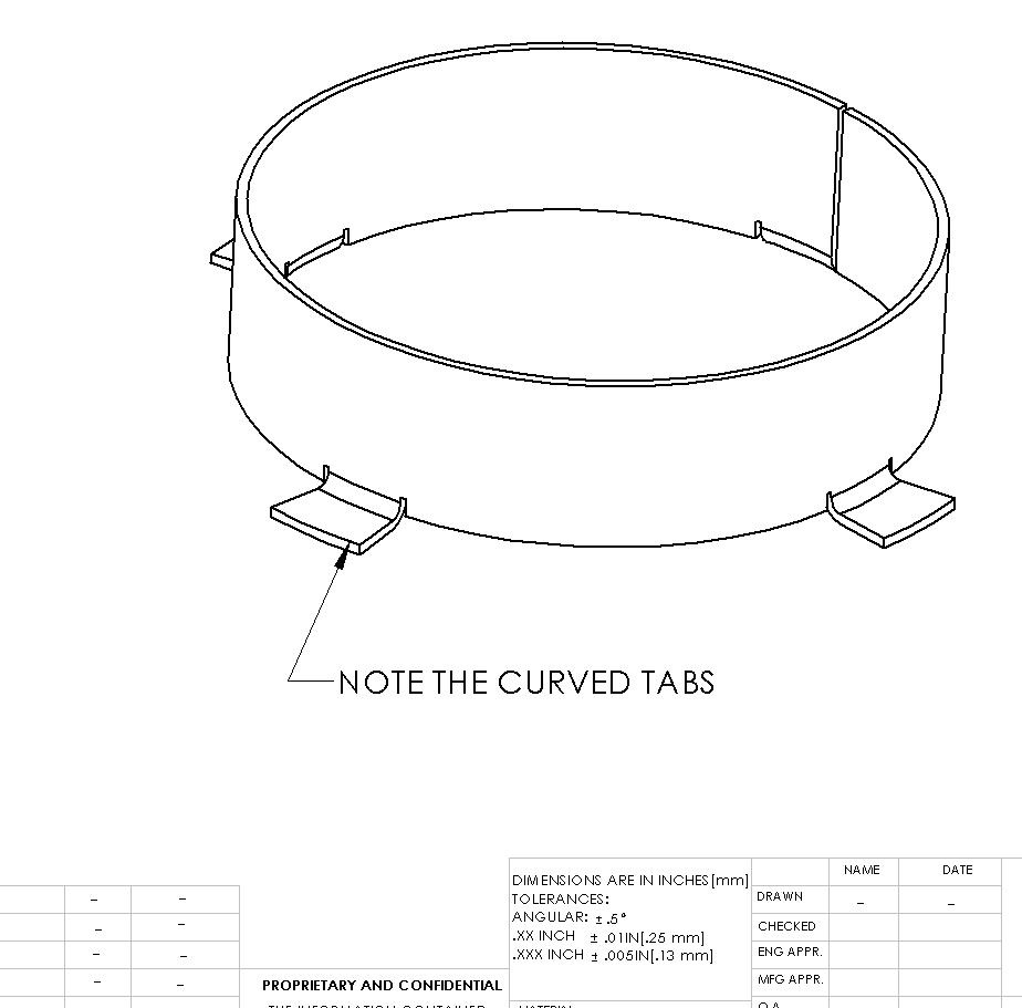

how to add tabs to curved sheet metal part?
cannot select a planer surface since it is curved.
if unfold it then add tab, the part cannot be fold back????

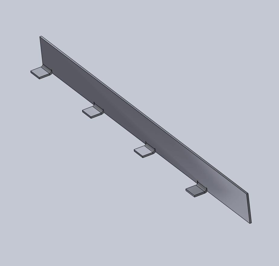

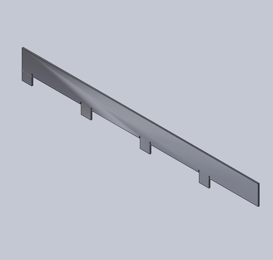

I'm no sheetmetal guy, so forgive me if I don't know what I'mtalking about, but can the part be made in the real world? If thetabs are added but not bent before the part is rolled (to make itcircular), they'll be curved like the part. (See the third andfirst attachments) It would then be difficult or impossible to bendthe tabs because they're curved.
If the tabs are added and bent before the part is rolled, the tabswill deform when the part is rolled because they'll either becomecircular like the rest of the part or they'll unbend to accommodatethe curve. (See the fourth and second attachments.)

It would be very easy to bend the tabs shown in the first image. Inthe real world, metal can be stretched and deformed far beyond thecapabilities of SW.

I'm trying to do something similar. I am trying to recreate this autocad drawing into Solidworks and make a flat pattern from it but I am completely lost. I tried to do what Kelvin showed above but it doesn't flatten correctly. The part should flatten longways instead of up and down like it does in his part.
I have the CAD drawing attached.

The problem is creating a tab on a round surface. The first jpeg attached is of the round part folded and unfolded without tabs.
