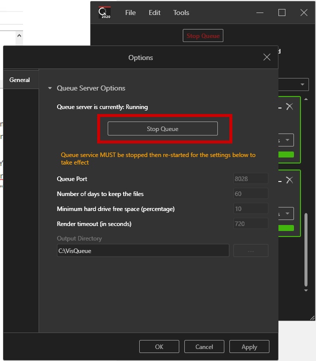

  • Purge your queue occasionally or if you're having issues. I usually stop and restart the services when I do this.
  • If you have multiple versions of visualize installed, ensure previous visualize queue manager and boost versions are not running. Uninstall all previous visualize versions otherwise they conflict. I've had difficulty removing my previous installation's services so I have to make sure the old 2019 services are stopped.
  • The "stop service" and "start service" usually has to be done both from within the queue manager as well as the Windows task manager. Stop in visualize, then ensure it stops in windows. Then restart in windows and start in visualize. Flip flop back and forth until it works.

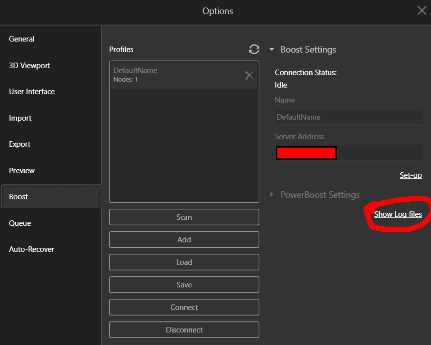

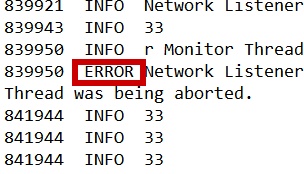

  • If your renders are failing, check the log files which you can find a link to in the settings. You'll learn to look for fatal errors and warnings in the SWVisualize.Queue and SLDWORKSVisualize and OfflineRenderer files and SWVisualize.Queue.Server. This can hint at what is going wrong. "String maybeFullPAth" or "String fullPAth usually means your file name is too long. All you really care about are the ones that say "WARN" or "ERROR"

    •  Change your Queue Output directory to somewhere in your root directory of your local hard drive. Windows has a 255 character limit and for some reason Visualize likes to make huge long deep directories for where it actually stores files. A simple short name is already at 96 characters out of 255 available on my root directory. Put that in your user directory and it'll get to 255 in a hurry. This will allow you to use longer more descriptive file names.

      • For me the files are at: C:\\VisQueue\\Username\\ Render File name \\jobs\\ Really Long gibberish \\output  (See how you reach 255 characters in a hurry?)
  • Don't save your output directory to a networked drive. Always use a local drive. For some reason at least our network connection isn't stable enough and can lead to failed renders.

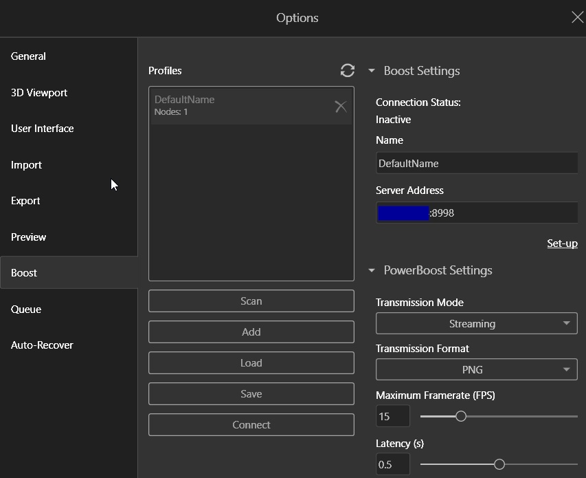

  • Be gentle with Visualize if you use the PowerBoost feature. Don't do any work until powerboost starts to kick in. Queued camera movements and appearance changes while it's trying to load will cause it to crash Visualize. Be patient while it loads. Save before you initialize Powerboost. Also, within Visualize, be sure the boost cluster status reads as "Rendering" or "Connected". Mine usually crashes visualize if it reads "Idle". Click "Connect" to re-connect and it should be good to go. I'm not quite sure what it's doing here.
  • PowerBoost is really handy when you want to preview the final render. I can get up to 20 passes per second with my RTX 4000 on a fairly complex assembly. With my Quadro P4000 on my workstation, it's about half that. Beyond that, I don't use it since it's too unstable and it needs to re-upload to the queue every time you change something.
