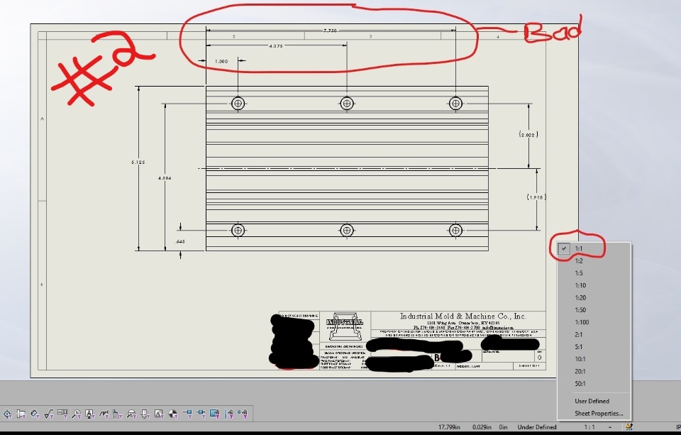

How do I stop solidworks from scaling the annotations position when changing the sheet scale?

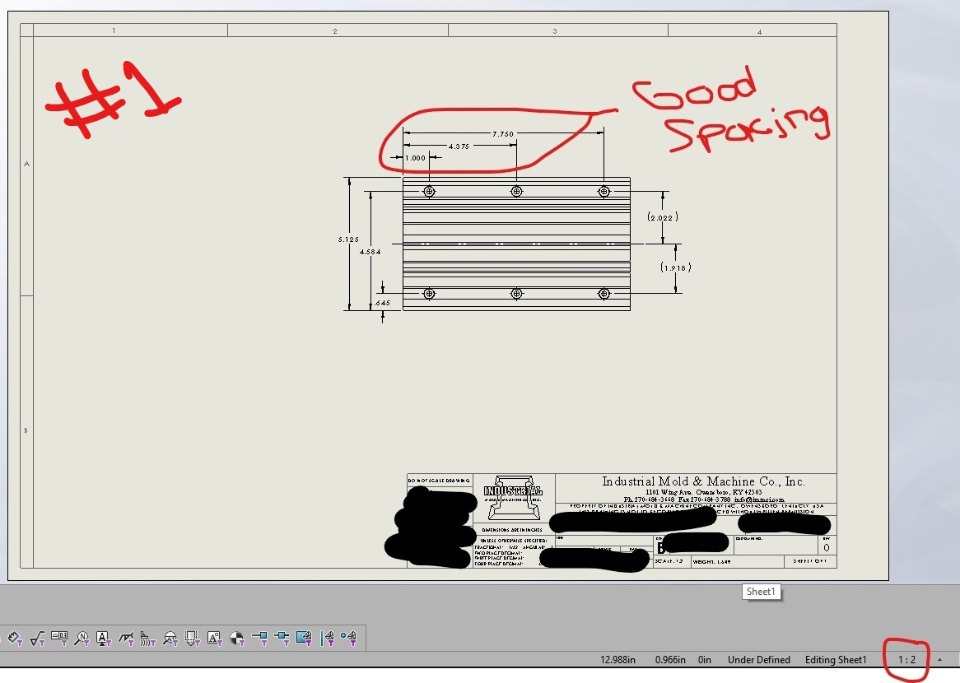

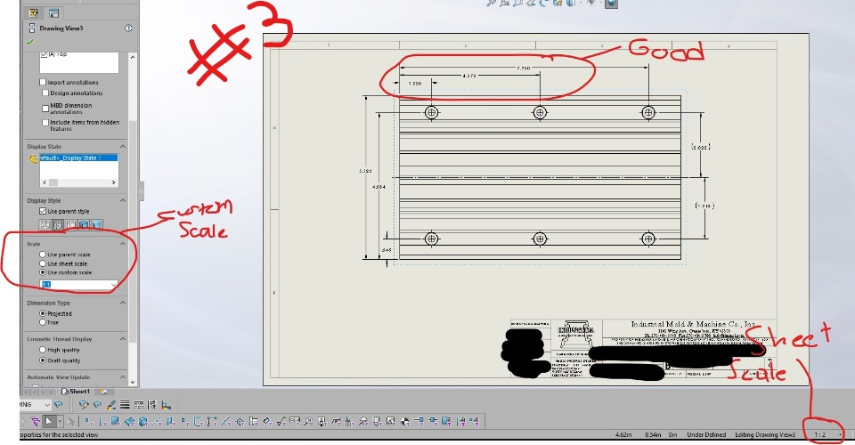

I added pictures to help explain what I want to achieve. Picture #1 shows the drawing with a 1:2 sheet scale and the dimensions are set to the correct height. I want to change the sheet scale to 1:1 but when I do the dimensions position relative to one another changes (picture #2). Picture #3 shows the dimensions in their right place with the right scale but I had to change the actual drawing view scale to a custom scale via the property manager.

You could stop solidworks from scaling the annotations position by first create all views you need on the drawing, combined with the sheet scale and maybe a few views in different scale, and then start adding the annotations?👍
FL
FL 2021-06-02
Check your Dismissed Messages.
I think one ask what you want to do when change view scale.
