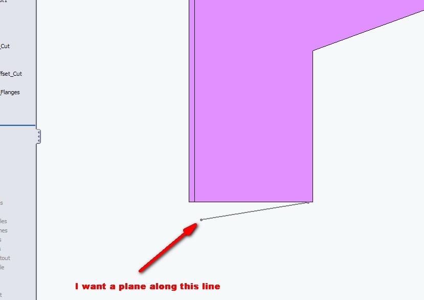

I cant for the life of me create a plane along this line. Imay be having a brain freeze, but can someone tell me how to createa plane along this line?
see image

when you say "along" do you mean you wish the line to lie inthe plane? can you upload a file?

Not enough info. You need more than 1 line to define a plane!
That is, unless you want the plane to be normal to theline...

I think I know what you want. Create a reference plane usingthe "At Angle" option. Select the plane you used to sketch thatline, then also select that line, and put it at 90°.
