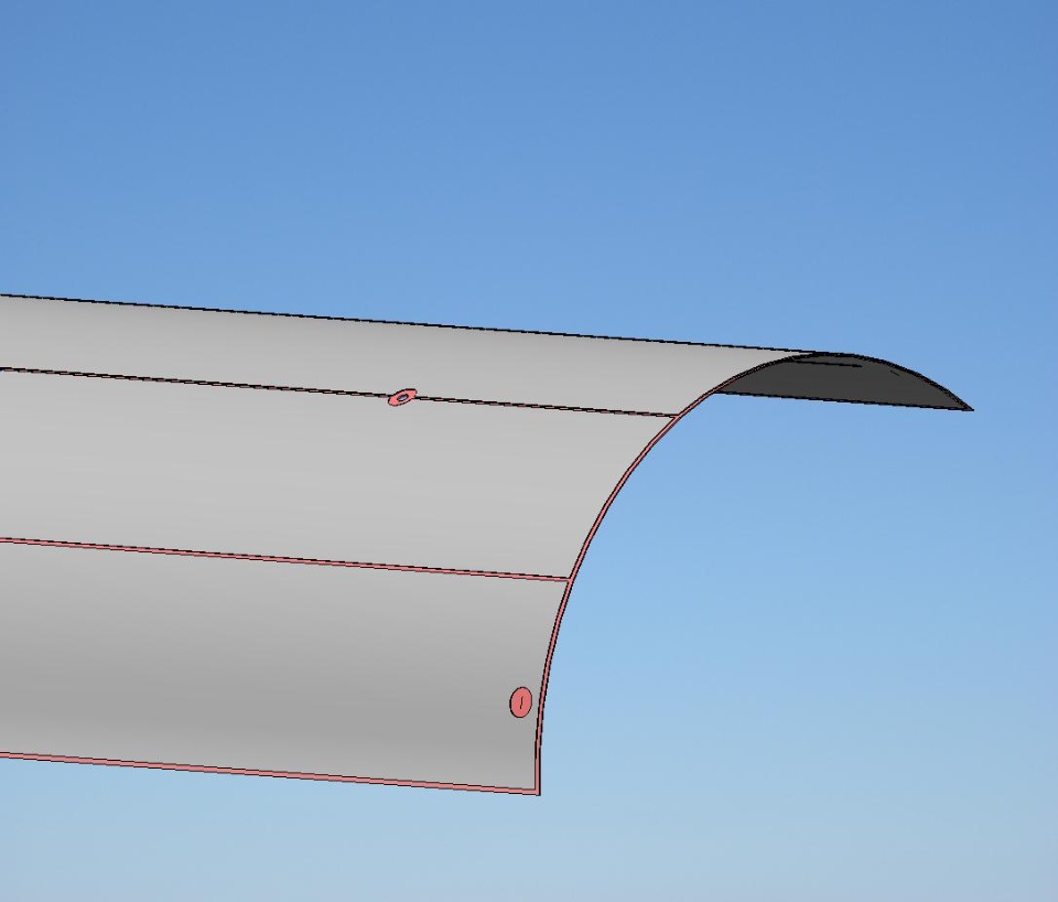

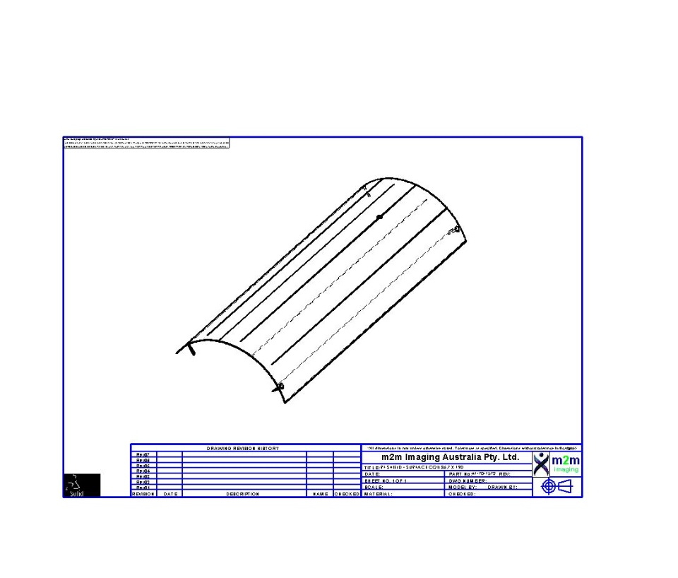

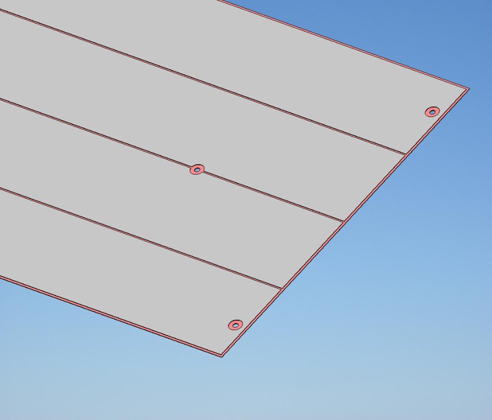

I have a part that is to be cut from thin material then has apattern etched on both sides and some through holes added and thenrolled to form a curve. When modelling the part, I've modelled itflat, added pattern and holes and then used the flex feature. Itworked as I expected except some of my holes closed up after addingthe flex. Also I get some strange results when doing a drawing ofthe part. I've added some screenshots. If anyone has somesuggestions it would be greatly appreciated.

I don't have solidworks up in front of me so I can't verifythis, but check to see if there's an option to create analyticsurfaces and uncheck it. Your holes could be getting generalizedout of existence.

You might try using a Deform feature instead of Flex. Itshould create a more accurate part (not stretched, or stretchedexactly as much as you want) and is less flakey than Flex. It doestake a bit of time to figure out. Use curve-to-curve.
