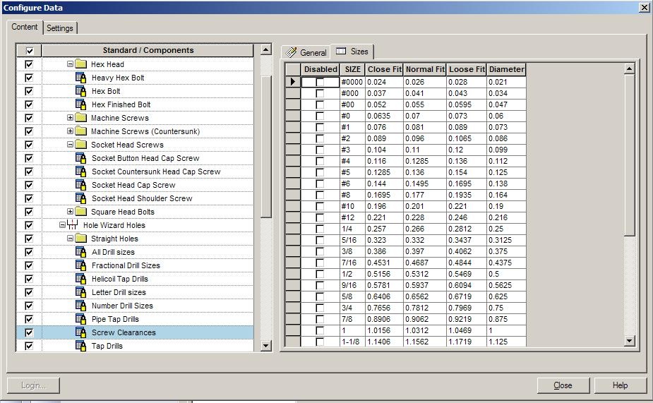

Does anyone know where the file is that controls how much it addsto a normal fit hole to make it a loose hole.SolidworksDrawings And Detailing
Comments5
AW
AW2008-07-29
The Toolbox and Hole Wizard data is stored in a MicrosoftAccess database. Look for swbrowser.mdb. Once you make changes tothis file you should save it to a network location. That way itwill not be over written when you update SW.
A better option for you is to create your own standards by copyingexisting toolbox standards. (This will change the Access databaseabove, a much easier UI to deal with then the raw Access database).
Go to Tools > Options > System Options > HoleWizard/Toolbox > Configure to access the database. Copy anexisting standard then you can make updates. Poke around in thedata tabs and you will find the one that controls the hole fits.Again when you modify this standard here you are updating theswbrowser.mdb file. You will want to move this file to a networklocation, lest it get over written on a future SW update.
You can create a path to it's network file location under the HoleWizard/Toolbox tab in the SW System Options.

If your company has a set of standards which are different thanwhat SW has to offer, Anna's advice is the way to go. Copywhichever standard is closest to your standards and use this as abase, modify as required.
If you rarely need to modify these values, you can do so on the flyin Hole Wizard. (Note: You can also view the sizes individually byscrew size in the Hole Wizard .)
If you are just looking to compare these values to what younormally use, then
TOOLS > OPTIONS> SYSTEM OPTIONS > HOLE WIZARD/TOOLBOX >CONFIGURE>
Choose which standard you wish to view, expand Hole Wizard Holes,expand Straight Holes, choose Screw Clearances and then on theright side click the Sizes tab.
HTH
SF

The values used by SolidWorks in the Hole Wizard are from ASMEB18.2.8, Cleaarance Holes For Bolts, Screws and Studs. The ASMEstandard for imperial & metric sizes are based on ISO 286, ISOSystem of Limits and Fits as follows: H12 - Close Fit H13 - Normal Fit H14 - Loose Fit
The original system DIN (Deutsches Institut für Normung eV(German Institute for Standardization; similar to US ANSI) wascreated based on comprehensive studies conducted on machines,machine tools, type of machining, machine capability, machine shopcapability, etc.
By the way, SolidWorks also supports Fit Tolerancing for standarddimensioning.
If you are intending to make changes, I would review and understandthe referenced specifications first. Then I would make an informeddecision and change the range of tolerance based upon anotherexisting Fit Class. I would by no means arbitrarily select ordetermine a tolerance on my own. ...Why reinvent the wheel?
