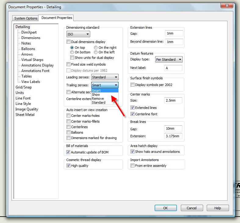

Can anyone help ? I would like the Hole Table to displaytrialing zero's after the decimal point ie 57 should read 57,00 or21,1 to read 21,10. Anyone know how to set thisSolidworksDrawings And Detailing
Comments7
AW
AW2008-09-14
Change the Document Properties, then be sure to save yourTemplate.
See attached.....

Anna,
I also would like to show the hole size to be 3 pls.,
I tried as you suggested with no luck, The only way I can get the holetable to be three pls callout forthe hole size was to change the default units of the drawing to be 3 pls, thenall dimensions go to 3 pls. if I change it to be 2 pls then theentire drawing goes to 2 pls. including the H.T.
You can go in and select row by row to change to 3 pls or theentire hole table. I could only get the holetable to go to 3 pls a row at a time, butwhen you save the table it is not save the changes. If I select the entire hole table to be three pls it also does notwork. SW2008 Sp5.1 Frank
SF
SF2009-03-25
Frank,
Using SW06 & 08, I can select the hole size in the table andthen adjust the number of decimal places in the property manager.With SW08 and up, you have individual control for all dimensions ina hole callout, such as depth, c'bore dia, c'sink dia, c'boredepth, etc.
Also, if you select the table in the upper left corner, theproperty manager will be displayed for the hole table. Using thisinterface, you can adjust the number of decimal places for holelocations.
Your defaults for all other dimensions and such remain as they wereper your document settings.
With these controls you should be able to do what you are asking.
It would be helpful to know what version of SW you are using, youhave everything but in your signature.

Eddie, I am using 2008 sp5.0,
I tried this and nothing happens, the table flashes butnothing changes. I tried a template out of the PDMWE vault and still does not work
The only way I get it to change is by row or the defaut doc. unitsetting.
Thnaks Frank

Well Frank, that is very odd, we're using the same version.
The attached image shows a change for the hole location from thedefault of 2 decimals to 3. This was acomplished via the propertymanager for the hole table, "Hole Location Precision".
I also modified the number of decimal places for the tree differentholes using the "Size" property manager. Each hole callout wasselected and then each dimension & tolerance changedindependently. As a matter of fact, the first hole callout has beenset to use 1, 2 & 3 decimal places.
If you go to Tools - Options - Document Properties - Tables, do youhave "Automatic update of hole table" turned on? Also, what drawingstandard are you using? I'm using ANSI/ASME.
I really cannot think of anything else.

Eddie,
I am using ansi and Auto update is on, I also find this odd, I will be sending this to my VAR.
