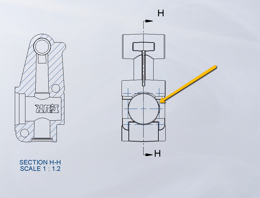

Hide feature beyond section plane.
Hello;
The logo, is on the surface where the arrow points, I would rather not have it show up in the section view. This is all one component. I know with an assy I could hide the component, but how do you do this if it's just a feature? When I attempt to hide the feature, everything get's hidden.
Thanks in advance for any input;
Rob_d SW 2019 sp5.

MS 2021-06-11
You might try a hide/show edges on the lines you don't want to show. just right click on a line, and up at the top there is an option to hide/show lines​. Unfortunately, you have to do it for each line separately, but it is the easiest.

FL 2021-06-11
I don't think it should section the logo.  Could be a bug.  Contact your VAR.

JB 2021-06-12
can you post the model?

KC 2021-06-14
Reverse the section's direction.

SD 2021-06-14
Depending on how the feature was made, you can try turning off tangent edges​

AT 2021-06-15
You could try "Hide edges" in that view. Sometimes works, if there are not multiple edges superimposed.

FN 2021-06-15
The logo was extrude into a model???
if not, uncheck merge solid and hide this operation in this view.

JB 2021-06-15
Well, you might be able to set your section depth to less than that of the text.  It won't look the best though.

FL 2021-06-15
Check and make sure the text did not extrude in the hole.
