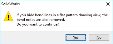

In the macro I traverse the feature tree in each view, identifies and selects the bend-line sketch and then uses the ModelDoc2::BlankSketch to hide the sketch. In SW2017 you get the warning: "If you hide bend lines in a flat pattern view..."
In SW2014 I didn't get this message when running the macro so it wasn't a problem until now. It will be annoying for the users so I dug into it to get rid of this warning. First I tried to select each note and hide them before using BlankSketch - same result. Then I stumbled across IView::ShowSheetMetalBendNotes which hides all bend notes. When using this first BlankSketch activates without the warning. Voila!
