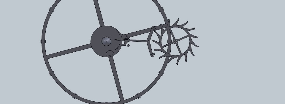

So I am trying to animate an escapement mechanism for a mechanical watch but I am not able to do it correctly. The parts somehow seem to be bounce when they hit another body and I cant seem to know what I can set the restitution value as. Any help will be appreciated. There is one part supressed because I was trying to isolate the problem and do one thing at a time.
If you can, please do unsuppress the part and complete the Motion Study with it rotating.
Here's the attachment.
Attachment of the Assembly
Thank You. Looking forward to know what's wrong.
#motionstudy #escapement #watch

Actually I got the solution to my problem from another forum but I am using SW2018 and the solved answer was SW2019. Think anybody can save it backward compatible for SW2018?
TB
TB 2019-11-06
I am back to ask more. Yes, I somewhat figured out what to do but my current situation is an oddball and don't know what to do. I want the balance lever to stop the movement of the escapement gear. But the Gear is instead pushing the lever back and forth without the need of the balance wheel.
I am attaching the video here and also the zip of the assembly like you had asked earlier (I didn't know there was an advanced editor which allowed attaching file).

Well, solved my problem.
Just have to be careful with the speed of rotation.
