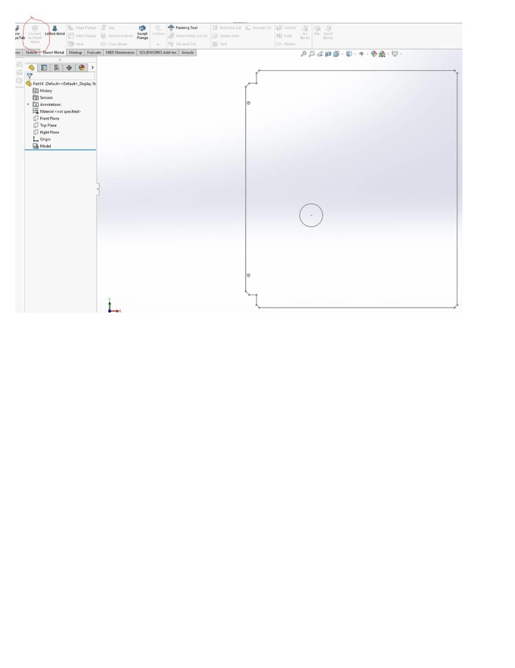

Convert work with solid parts.
Follow instruction in tutorial.
As Frederick said Convert only works on solids. What you need to do is turn that sketch into a web, then you can bend the flanges using sketch bend. You'll need to know the center line locations to accomplish this though.
