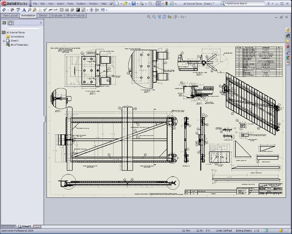

am i missing something here.. my revision symbol in the toolbar is greyed out. why cant i use it?SolidworksDrawings And Detailing

What caused this confusion for me is that our template is setto allow the revision table to only be on page 1. However, SW willallow you to put revision tables on other pages, but they don'twork correctly. E.g the add-symbol options are grayed out or notexistent.

Add a revision table and then a revision row and then you'llhave access to the revision symbol. Your drawing doesn't have arevision table hence SolidWorks thinks you shouldn't be able to adda revision symbol. I guess that's the intended behavior.

First add a revision table on the drawing.
Then reight click on the revision table > Revison > Add Revison.
Now u can see the Revision symbol is fine.

REVISION TABLE AND REVISION ADDED, REVISION SYMBOL STILL GREYED OUT

I found a workaround:
create the revision table on the 1st table
cut and paste to the page you want.
Worked for me!

I was having difficulty here because if you add the table on sheet 2 it won't let you have symbols, it needs to be added on sheet 1.
