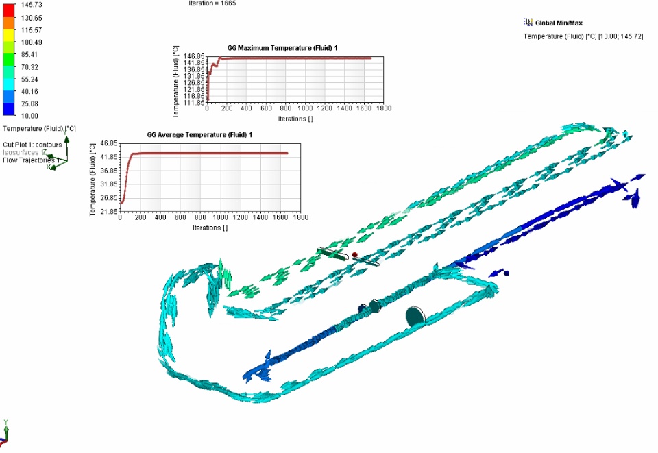

I've set up a flow simulation of a cooling block (with water running through) of a system to export fluid convection to simulation for heat analysis.
Everything works and seems about right; the fluid temperature rises as it picks up heat from heat transfer.
One thing I'm having trouble understanding is the "maximum temperature" plot. Only space where fluid is traveling is shown below. Solid has been hidden for proprietary purpose.
I'm not sure where 145C is coming from. The Max and Min points are shown but no where is it supposed to be 145C.
Can anyone tell me why the flow simulation is giving me such high max fluid temp? The only space/place where fluid is running is shown in this flow trajectory. While min fluid temp as shown on top right is 10C as it should based on the fluid input and the output-supposedly the hottest-should be about 85C looking at the exit per trajectory color..

Refining the max temp region(point) to move to another location and another.. I chased the max temp regions until it moved to a non fluid region.
I decided to leave it for now.
I still appreciate all the tips. Thanks!

The two bodies are coinciding. Although, in reality, there is probably silver brazing material between.
None of the two bodies nor the fluid exceed more than 80C.
The region and the entire assy are well within the domains.
I'm currently trying to refine and display mesh at the max temp region.

Is this location between two bodies that are supposed to be in contact but form a sliver gap instead?  Maybe make sure they are overlapping a bit by offsetting some of the surfaces a pinch using "Move Face".  SFS handles overlaps with a "Material Priorities" list.
Is this location near a computational domain boundary?  Maybe move the boundary a tiny amount.
I don't know that Mesh Refinement would help much since the cells might need to be more than 2 ^ 9 smaller than your basic mesh if it's the issue I think it is.

The region is a stretch of water channel that is over 4.5mm tall and 30+mm wide.
I've tried XY XZ YZ planes, interpolation turned off, refining mesh in the indicated max temp region.
The cut plot max tag doesn't show 145C when it's played through axes.

Adding to what Shaun already suggested: To understand what is happening at the location of the global max temperature, Create Cut Plots passing through the location of max temperature, and display the mesh (and maybe the streamlines). Study the cut plots with different orientations (perpendicular to Y, Y or Z) so that you don't miss anything. Plot temperature, but also thermal gradient.
Typically, users resolve this type of problem by adjusting their mesh settings, or by modifying the geometry to suppress narrow channels if they are insignificant to the simulation.

Is the region of maximum temperature located in some tiny gap/opening in your model?  Results can be strange in these regions especially if you only have a partial cell capturing it.  Usually they can be safely ignored, but I would usually take care of these types of things when cleaning up the model.  Using cut plots with interpolation turned off can sometimes help examine the culprit in more detail.
