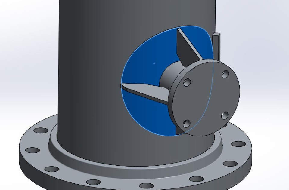

I am trying to create a flat pattern for a sheet metal disc that will be rolled to Ø10 3/4". I can create the part, but the flat pattern fails. The component is highlighted in blue.

The way I got it to work is to start your original part with a square sheet metal part.
Then sketch a circle with a square bigger than the first sketch so that you can cut everything out and keep the circle.
The flat pattern still exists so just unfold it and its flat.
Edit: I'm copying Chris England's post because it shows it better with a picture. Make a square sheet that is already curved to start with.

For a wrapped plate like this, I typically start with a base flange that matches the curvature of the cylinder and then cut away the excess.

Convert to sheetmetal doesn't work for this profile.

When I attempt this type of cut, it doesn't allow me to flatten.

Did you look at the part I attached in my first comment? It flattens fine.
Make sure that you have 'Normal Cut' enabled.

I did a lofted bend to create the tube and then did a cut extrude thru that tube. It left some odd geometry at what would be the normal bend line but appears to work.

here's how my feature tree looks when I try to unfold. I created a curved sheet metal item, extruded a normal cut, and it tells me I need a "fixed planar face or linear edge"

I found 2 curves are overlapping I made it one curve it worked. I do not know the reason.
