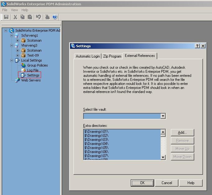

We have a few assemblies that have been created outside ofour Enterprise vault. I these cases the assemblies referenceseveral parts that reside inside our vault, but because theassembly was created outside the vault these file were copied to anetwork directory and references copies location not the vaultfiles.
We have checked in the top level file and deleted the copies of theduplicate files. So now when we open the assembly we get a numberof errors locateing files. Example below:
Unable to locate the file C:\\PDME_Vault\\EngineeringData\\TP\\Mechanical\\900315.SLDPRT. Would you like to find ityourself?
The way we are doing it now is manualy clicking through the vaultdirectories and finding the files when we open the assembly.
Our vault is setup to not allow duplicate file names. Is there away to automatically search the vault for the 'missing' files. Thevault doesn't allow duplicate file names, so there will be only one900315.SLDPRT.

There is no current capability to have the SolidWorks searchroutine do a search on the Enterprise PDM vault view to findmissing references. If the SolidWorks search routine does not findthe files (the search routine is described in SW Help) the browsedialog will be shown. Once the files are located via the browse,the reference will be updated once the file is saved in SW.

As long as the filename have not been changed, you can addthe Vault locations to the SolidWorks "File Locations | ReferencedDocuments", then SW will find the files, if you have a local copy.The easiest way to make sure you have a local copy is to "GetLatest Version" of the folder containing the referenced files.
If you want SWEPDM to find the files upon check-in of the assembly,then you need to add the vault locations to the "ExternalReferences" for your vault through the Administration tool (seeattached).

if the users have his files in local drive then how we canuse this settings?
AC
AC 2009-02-11
In addision to Calvin,
you can export import the PDME external references setting to allthe users by exporting the registry key:
HKEY_CURRENT_USER\Software\SolidWorks\Applications\PDMWorksEnterprise\Vaults\VaultName\PageXRef\ExtraDirs
