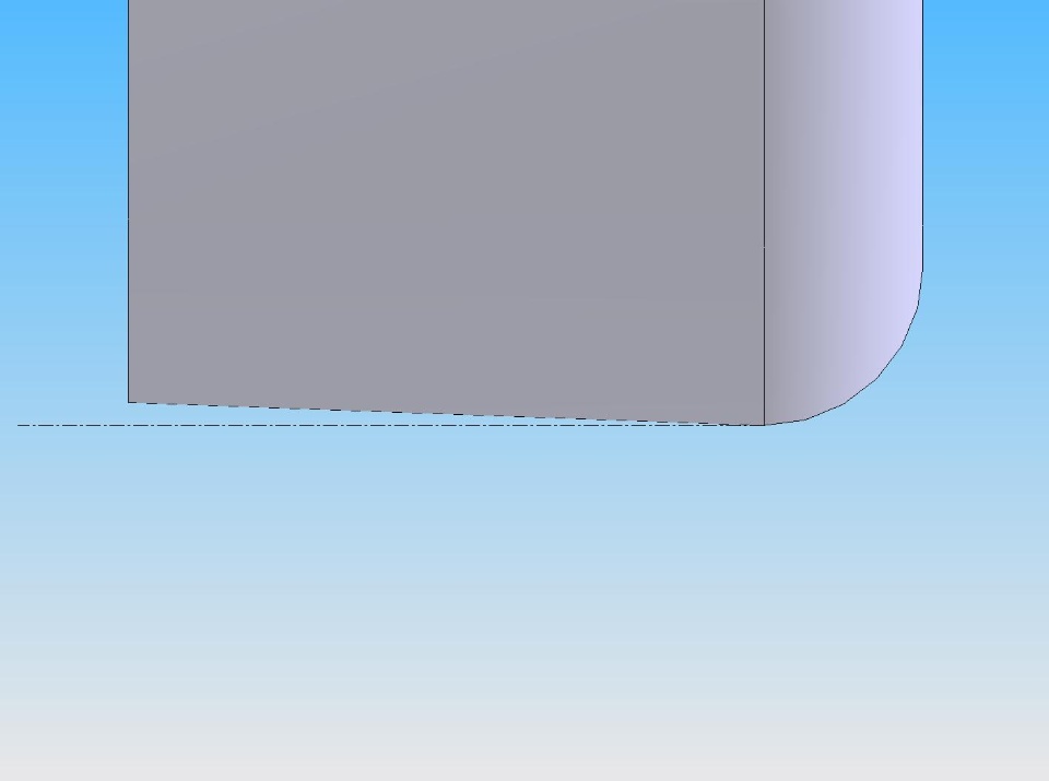

I hope this pic will show it a bit better. I added acenterline that shows where the line of the part should be. Thispart is nothing but a simple revolve with one fillet. The crazything is it doesn't do this on the opposite end of the part.
Matt,
I tried all of the quality and anti-alias settings with nosuccess.
