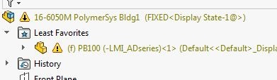

You can rename Favorites Folders in an assembly. Favorites simply creates a folder which contains representations of chosen components, and keeps it (or them, as you can have multiple ones) at the top of the Tree. I can't say that it reproduces the component, because it only represents it in an additional place. I find it most useful to make a Least Favorite folder which contains all the Erroneous imported components so that I can easily suppress them in a 'CLEAN' subconfiguration. The benefit of my use of a Clean subconfig is that I can work in superassemblies and drawings without being slowed down at every turn by propagated errors in the calculations, then switch config as the last step before rendering a PDF to export the document. It's better to work without erroneous components, but sometimes you have to make do with what works now, particularly after months of invested design and build-up.
Example, with only one erroneous component included:
This is far more useful when there are handful or more such components, but this illustrates re-purposing of Favorites into its opposite.
