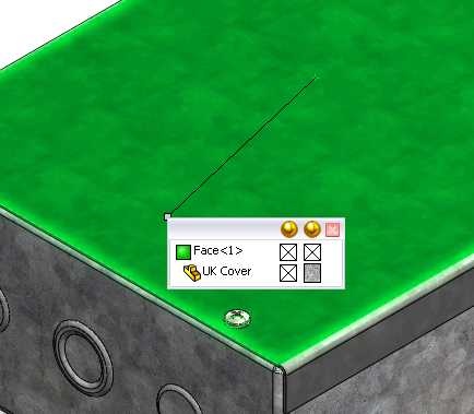

Face Appearance Callout got turned on, can't turn off!
Somehow, I managed to turn on something that causes a calloutpopup to appear eveytime I click on a face. This is really annoyingwhen you are trying to do anything. It only started occurring afterI imported an autocad .dwg file to make a part from.
Any ideas on how to turn this thing off?
I know I can turn it off by deleting the solidworks registry fileand rebuilding it, but short of that, any ideas?SolidworksParts And Features

click onview on the title bar thenappearance callouts near the bottom

This helped me a lot.
I am a novice to Solidworks and used solidworks for only about 4weeks.
These "Appearance Callouts" started popping up soon after I usedCOSMOS.
And for two to three weeks I thought that's the usual (painful)way.
Thanks to Mark, Garret, and Paul, I could get rid of them or invitethem!
