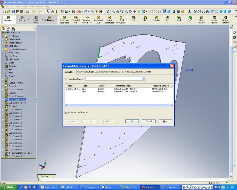

Iam having troubles with externalreferences. When I made myassemblies, I always kept 'NO EXTERNALREFERENCES' button on, sothat I won't have a problem withthem.
Iam trying to pack and go my topassembly and apparently noticedthat although all externalreferences are broken, some parts arestill trying to pull relatedassemblies. I opened one of that partsand looked for externalreferences, and all shown as broken(screenshot attached).
Why would it do that? Did anybodyhad similarproblem before?

Arslan,
What I suggest you do is open the part 1000637201 and editSketch9. Then in the drawing toolbar click"Display/DeleteRelations".  In the Feature manager, checkthrough thelist of relations, and delete whichever one is linkedexternally,and re-create it in a more appropriate manner.
There are many ways to create relations between parts, so Ican'ttell you how it happened in your case; but the proper way todeletethem is the way I detailed above.
