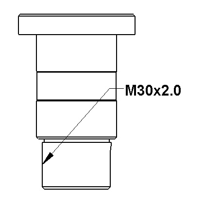

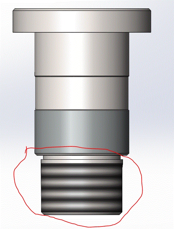

I have a part and added a M30 cosmetic thread. The thread shows on the part file, but It will not show on the drawing. The thread size is called out on the drawing, but can not see it. Everything is checked at the part file level. What am I missing? Thanks

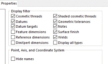

Are all the Cosmetic Thread related checkboxes also enabled in the drawing file?
