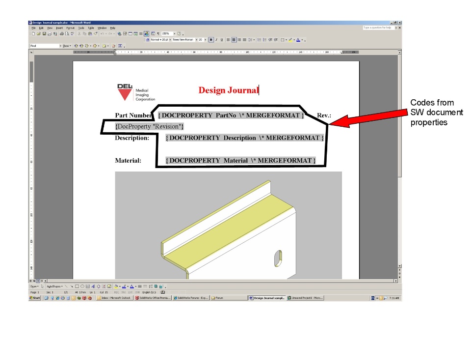

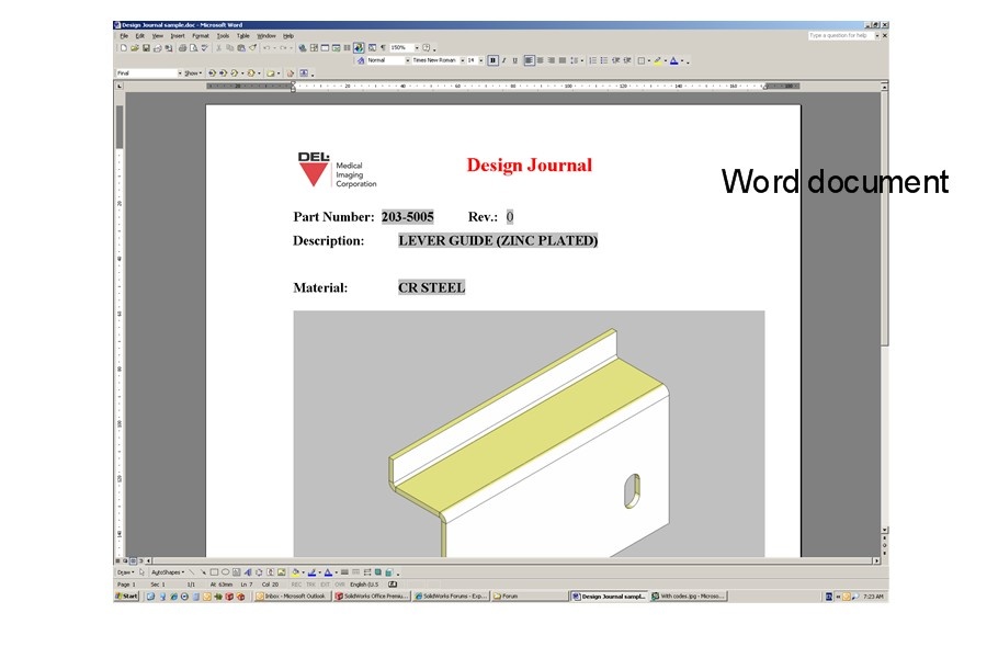

Mike, I used "Design Journal" ,which is "Word"document,for thistask. Use existing SW template (save as copy in your directory)andmodify it (need know how to work with Word code). In SW System Options add your file location for"DesignJournal Template" and now under DESIGN BUNDER open Design Journal, you will receiveWorddocument with desirable (created by you) properties. Hope it will help. Sorry, but this forum doesn't allow me to upload Worddocument forsample.

Attached please find JPG samples. Need more information - e-mail to me Thanks
