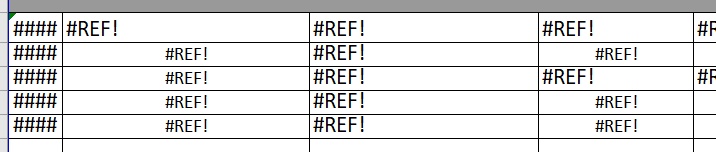

i using excel base boms in solidworks and i link the data to another excel file (fileA) (copy&paste link). once i reopen the fileA, it display like this and cannot be resolved.  How to solve this. plz help me
i using microsoft office 2019, solidworks 2019
