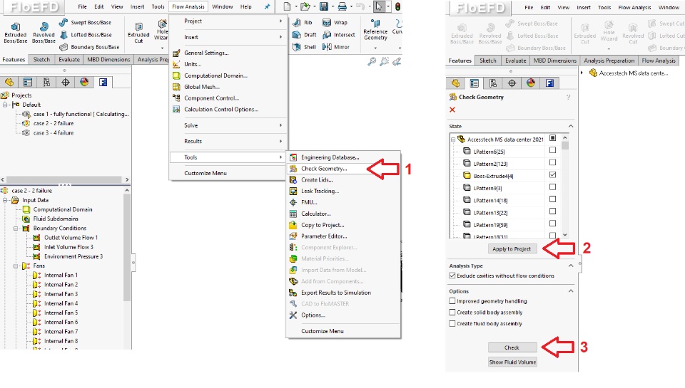

Step 1: [Flow Analysis] --> [Tools] --> [Check Geometry]
Step 2: Click [Apply to Project]
Step 3: Click [Check]
Step 4: Exit [Check Geometry]
Step 5: [Flow Analysis] --> [Project] --> [Rebuild]
Step 6: [Flow Analysis] --> [Solve] --> [Run]
