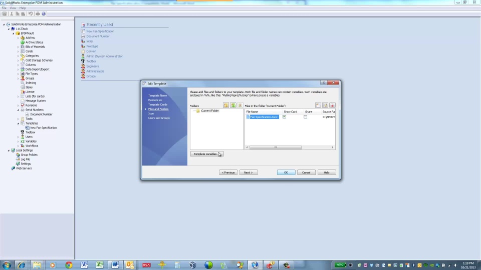

  13. Template wizard needs ability to delete missing variables, without remaking entire file/card. (See Joy's workaround below)
  14. Template wizard - Automatically make template variables based on the template card variables.
