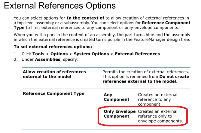

Unfortunately when I try to use this functionality this is what happens if I accidentally make a reference to something that's not in the Envelope SSP (red line below):
The VAR has sent me the newly created SPR on this 1157540.
Anyone using the SSP method I think will benefit from Envelope SSPs for the following reasons,
  1. It makes it literally impossible to make errant references, by setting external references to envelope only, you virtually guarantee you can eliminate them.
  2. Envelope components look different in the feature tree.  Making the SSP instantly recognizable.
  3. Envelope components are automatically eliminated from the BOM.
There's probably more, but those 3 are pretty big improvements.

I can see many advantages, and you can click the checkbox to make the dialog not pop-up (that's what the VAR recommended in the meantime).  I don't think I'll try to use it for anything production until this is sorted out but it does look like very useful functionality.

What option would I have on that wouldn't allow the surface click on new part as you showed in the video.  I get the checkmark, but the only way that goes away is clicking on a plane.  Any escape out of the checkmark does not leave the part created.  I can do it will made parts, click the check and they snap to the origin.
We force external parts, not virtual, but it looks like yours is external.  I can't see an option.  I had external references->envelope only but unchecking that still does not allow me to make the part.
SW2020sp2.
You are correct that if you have checked the option shown in the picture below, you cannot use the workflow I demonstrated. In my video, all new parts are virtual.

How do you not select a plane when creating a new part?  In an assembly you click "NEW PART", you are asked for name and then returned to the assembly.  The cursor does have a green checkmark, but the only exit is to select a plane that I can find.
The process you are describing would be similar to inserting an already made part into an assembly which will snap to the origin if you just click the checkmark.  Or, are you suggesting you insert 'blank' parts this way and then detail them out.
Simply click on the empty area of the screen.
2020 SOLIDWORKS Help - Creating a Part in an Assembly
For internally saved parts, instead of selecting a plane, you can click in a blank region of the graphics area (while the pointer is ). An empty part is added to the assembly. You can edit or open the empty part file and create geometry. The origin of the part is coincident with the origin of the assembly, and the part 's position is fixed.
