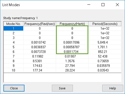

  1. In Frequency studies, the solver is better able to show ~0 frequencies for rigid body modes, most notably the three rotational degree of freedom modes (4-6 in the image below).

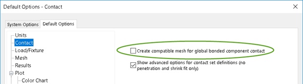

  3. The default option for bonded component contact is now set to Incompatible. You can change the default setting for the Component Contact (including Global Contact option) to a Compatible or Incompatible bonded contact type from Simulation Options > Default Options > Contact
