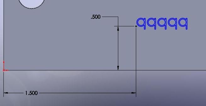

This might be easy.....How do I fix the location of embossedtext?
I have Tools>Sketch Eneties>Text, picked a fully constrainedline and inserted my text but the text appers unconstrained (Blue)and the resulting sketch appears not fully constrained in thefeature tree?

After you are done with the Text, when you close the textproperty manager, you will see a point with the text. Simpledimension that point. The Text color will remain blue but it willget constrained.
CC 2008-07-10
I always put my text on a line. so if the line is then fullydimensioned, the text will be, too.
