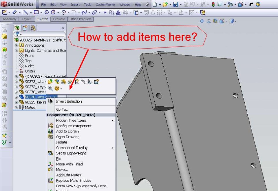

Editing Pop up -windows
Would like to add "Open Drawing" -icon to pop ups inassemblies.
1. Is it possible?
2. If yes - then how?
3. Tried to do it throug s-key, but could not find "Open Drawing"-icon. Where is it?

You can't add icons to those pop-ups. Only the S-key pop-upsare customizable.
Hopefully SW is thinking about making those pop-ups customizable inthe future.
Open Drawing icon under Customize > Commands > FlyoutToolbars, 1st row, far right. Also look under Standard in theCommands tab for the Create Drawing From Part icon.
Cheers,
SF
SF 2008-04-29
Through the API you can create an add-in that can addadditional items to the old right mouse context menu, the areabelow where you want it.
