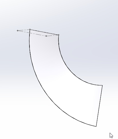

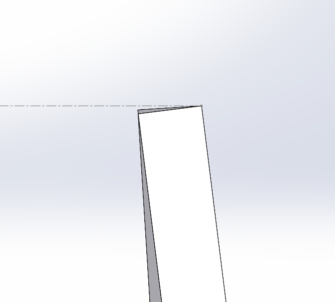

I'm working on a lofted bend sheet metal part, and having a hard time adding an edge flange on the end of the loft. The issue is that the end of my sheet metal profile is non-planar due to the loft feature. Any help would be greatly appreciated, thanks!

That is correct. I am hoping to find a way to cut the face or make it planar in some way. Thus far I have not been successful, thus the forum post.

I do not think edge flange will work here because surface is non planer.

So sorry, really gotta fix that habit. Here you are.

A part file would help.
