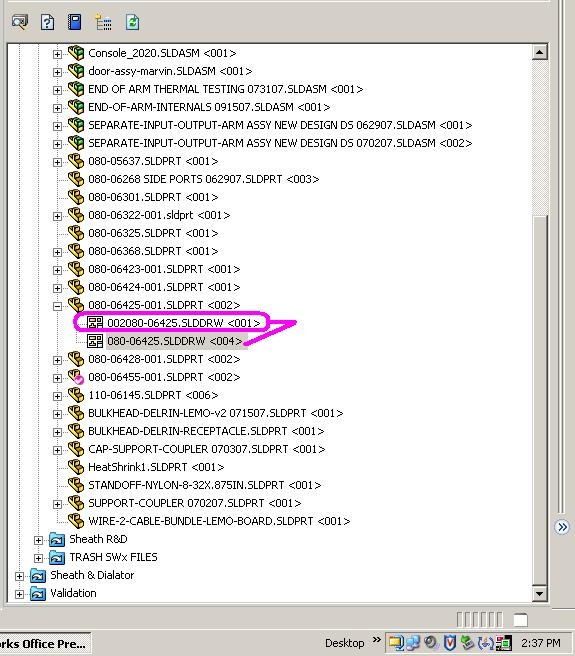

Upon Check-In of a SolidWorks Drawing, a duplicate Drawing file iscreated with the file Name appended. Please see the screeenshotbelow. PDMWorks 2006.
Any suggestions?
Any suggestions?

From what I can see in your attachment, it looks like you havemultiple drawings linked to the same part (080-06425-001.sldprt).This happens when both drawings are referencing the same part. Ifyou were to check out both drawings with the part file you will seethat both drawings are referencing the part.

Thanks for reply. Nope, one Part, one Drawing.
The 080-06425 Drawing, and it's Part 080-06425 previously existedin the Vault. The Drawing, at Revision 003, was Checked-Out,edited, and Checked-In as Revision 004.
The Drawing 002080-06425 never existed until Drawing 080-06425, Rev004, was Checked into the Vault. The Drawing was 'created' byPDMWorks.
