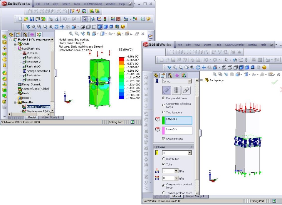

Dubious results when using springs
Uniform 1.0 pressure acts at the top. Boundary conditionsarechosen to produce uniform 1.0 vertical stress. The result is onthepicture. All stresses are sufficiently nonuniform. My impressionisthe spring "penetrates" into the solids.

According to my knowledge, we are using spring connector forgraphical representation, due to this it will not change itsposition.
