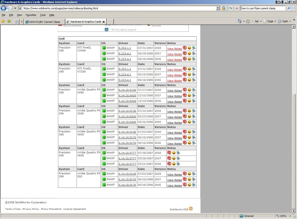

I have a Dell 390 with a nVidia FX550, and we are upgradingto SW2008. We downloaded the driver by choosing "Dell" "XP" and"Precision 390" and it recommends the 9136 driver. This doesn'twork with RealView in 2008, apparently.

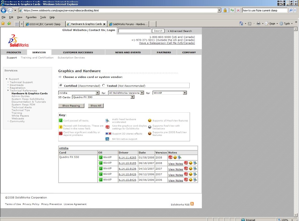

So we found out the hard way that if you choose "nVidia" as themanufacturer, "XP", and "FX550", you get different approved videodrivers.
Just a heads up for those of you d/l video drivers. You may have tocall support to make sure you have the real one theyrecommend!SolidworksAdministration
