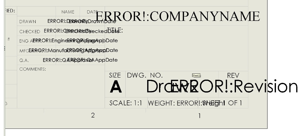

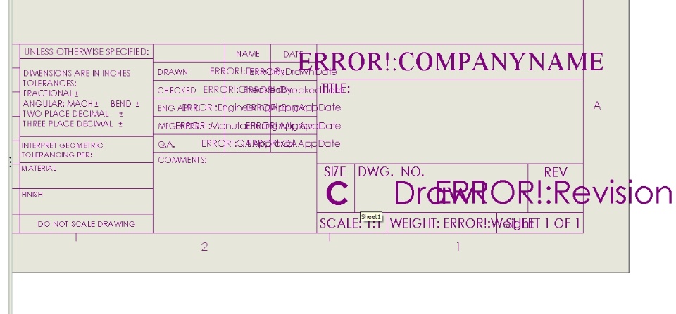

Drawing Templates Display ERROR!
A while back... maybe it was SP2.0, maybe it was SP2.1, maybeit was PDMWorks but all of my Drawing templates display ERROR!instead of the field remaining blank where information is notavailable. (ie. Description, Revision, CompanyName)
I'd like to avoid reinstallation to fix some disassociation I'veallowed...
Help, help?!
See attached JPGs.SolidworksDrawings And Detailing

Try this, VIEW pull down, then unselect Annotation LinkErrors. It''s a universal setting.
SF
SF 2007-01-09
Thank you. I feel like the sputz.

I usually just put a "space" in the custom properties if Iwant it to show blank.
