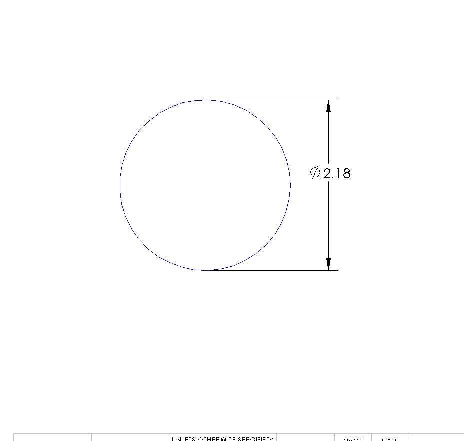

Hello All,
I need help with this one.Does anyone know if it is possible tonot display the diameter symbol when dimension round part. See file
Thank You.

TP 2008-06-05
Select the dimension, then in the Property manager on theleft in the dimension text area you will see MOD-DIM DIM change itto DIM (kept the arrows brackets)
MK
MK 2008-06-05
If you need to dimension rounds without the diameter symboloften, you may want to set up a 'dimension favorite'.
